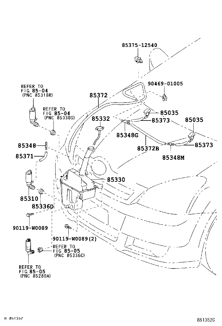

Колата е:
Моторче/помпа:12/2007 TOYOTA COROLLA VERSO (AUR10L-GWFERW)
SOL EUR LHD 2ADFTV DCRE 6F 05S
Диаграма:85035 NOZZLE SUB-ASSY, WASHER
85381-64020 2 € 18.36
85310 MOTOR AND PUMP ASSY, WINDSHIELD WASHER
85330-05031 1 € 131.32
85330 JAR ASSY, WINDSHIELD WASHER
85315-0F010 1 € 98.31
85355-0F010 WITH(HEADLAMP CLEANER) 1 € 98.31
85332 CAP, WINDSHIELD WASHER JAR
85316-0F010 1 € 4.95
85336D PACKING, WINDSHIELD WASHER JAR
90069-20005 1 € 1.13
85348 JOINT, WINDSHIELD WASHER HOSE, NO.1
85375-05050 1 € 10.59
85348G JOINT, WINDSHIELD WASHER HOSE, NO.2
85378-05030 1 € 10.21
85348M JOINT, WINDSHIELD WASHER HOSE, NO.3
85371 HOSE, WINDSHIELD WASHER (FROM MOTOR TO JOINT)
90069-46011 *H, L=50, WITH(HEADLAMP CLEANER) 1 € 19.59
85372 HOSE, WINDSHIELD WASHER (FROM JOINT TO JOINT), NO.1
90069-16010 L=5000 1 € 28.24
85372B HOSE, WINDSHIELD WASHER (FROM JOINT TO JOINT), NO.2
90069-16009 1 € 8.62
85373 HOSE, WINDSHIELD WASHER (FROM JOINT TO NOZZLE)
90099-33080 *H, L=100 2 € 7.41

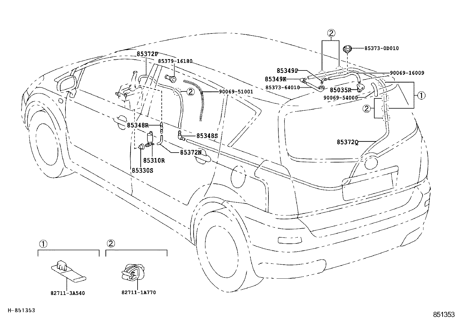

Снимка:
Задното стъкло се захранва от друго моторче.
Диаграма:85035R NOZZLE SUB-ASSY, REAR WASHER
85391-0F011 1 € 18.36
85310R MOTOR ASSY, REAR WASHER
85340-05011 1 € 131.32
85330S BUSH, REAR WASHER JAR
85348R JOINT, REAR WASHER HOSE, NO.1
85348S JOINT, REAR WASHER ELBOW, NO.1
85395-05020 1 € 44.94
85349K JOINT, REAR WASHER ELBOW, NO.2
85349P JOINT, REAR WASHER ELBOW, NO.3
85395-0D010 1 € 11.29
85372N HOSE, REAR WASHER (FROM JOINT TO JOINT), NO.1
85372P HOSE, REAR WASHER (FROM JOINT TO JOINT), NO.2
90069-46011 L=1490 1 € 19.59
85372Q HOSE, REAR WASHER (FROM JOINT TO JOINT), NO.3
90069-46012 L=3910 1 € 19.59
